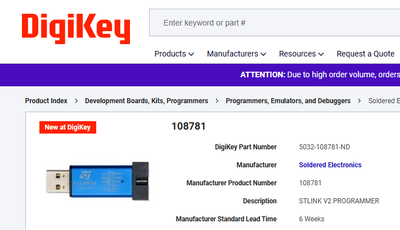

Hopefully our ST-Links are legit. We bought them from Digi-key.

2026-04-21 9:31 AM
@jwtuttle wrote:Hopefully our ST-Links are legit. We bought them from Digi-key.
Even DigiKey do sell clones:
Hence the request to see photos of what you're actually using.
