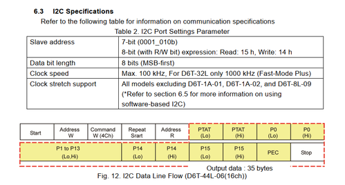

I'm now using D6T-44L Omron sensor to measure Temparature, i read the User mannual as the below
After that, i write my own code in IDE

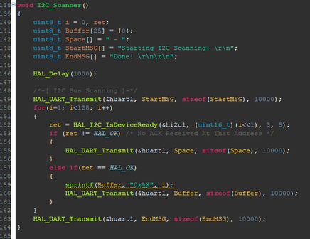

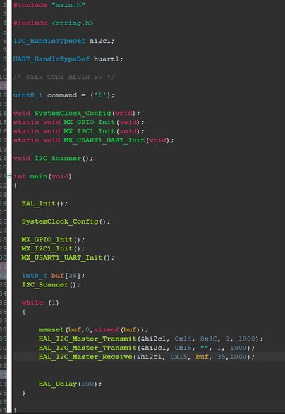

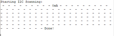

i use I2C_Scanner to check the device at which address is ready, here are my code and my result through UART to PC

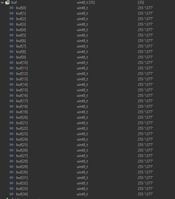

It seems everything is okay but my return value is always 255

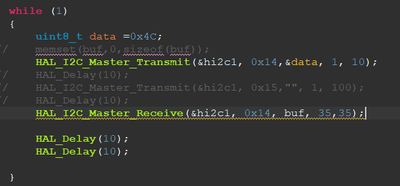

Thank for your reply,
I just found the solution
In HAL_I2C_Master_Transmit, i need to pass the address of the data command, because it is a pointer to data
so i need to modify the code like below

Hi
some basic questions: The Pullup are done? The I²C speed is max 100kHz?
Basic2:
The STM HAL takes the "shifted" address for read and write.
So your read and write adress have to be the same (0x14) the read/wirte bit will be managed by the HAL_
in your scanner you make a shift in the device ready with "i" but yo display the teh unshifted "i"
So try Transmit with adrr = 0x14 and a receive with adrr = 0x14
hth
