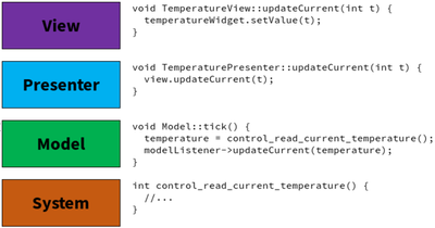

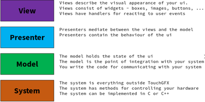

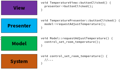

Did you respect this structure ?
From the display :
To the display :
