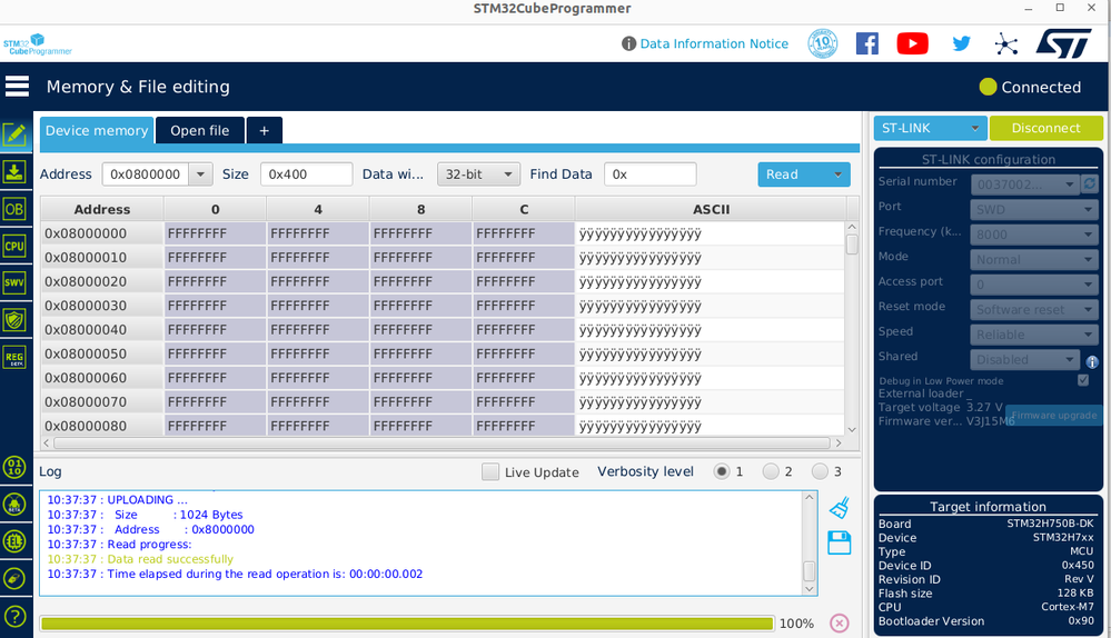

Can still erase via stm32cubeprogrammer attaching a screenshotScreenshot from 2024-05-22 10-38-12.png

Hello We are trying the flash the sample off the example called BSP which blinks led.I don't see why this would affect connecting to stlink. Also many folks have experienced this problem but there is not concrete solutions.
Also tried @mattias norlander  solution in https://community.st.com/t5/stm32cubeide-mcus/how-can-i-remove-error-like-waiting-for-debugger-connection/td-p/250559 to include  debug configuration > Startup tab > Initialization commands > Add: monitor flash mass_erase in the startup script. The Mass erase is successful then it shuts down connection
