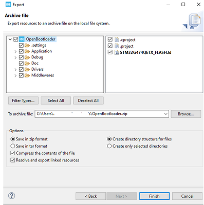

Hello @DeIng11 ,
Try export your project using "Export" > "Archive file" with following options:
