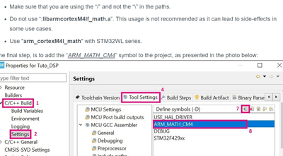

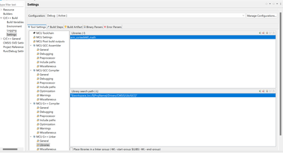

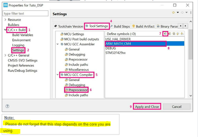

2024-11-28 5:21 AM
Since I am using stm32h742 this time, do I need to change M4 to M7 for these two below?
Best regards.

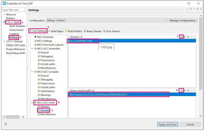

2024-11-28 5:34 AM - edited 2024-11-28 5:58 AM
Hello @baby_chicken,
Yes, the libraries depend on the core you are using.
So, from Project menu or File menu, go to Properties > C/C++ Build > Settings > Tool Settings > MCU CGC Linker > Libraries > Libraries (-l) > Add and insert the following libraries: "arm_cortexM7l_math," "arm_cortexM7lfdp_math" and "arm_cortexM7lfsp_math".
Please use ARM_MATH_CM7 instead of ARM_MATH_CM4.

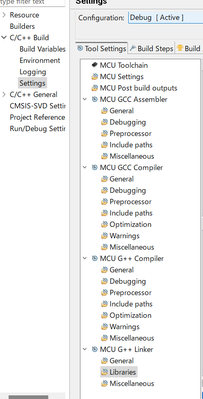

2024-11-28 6:30 AM
There is no MCU CGC Linker, but MCU G++ Linker is available.
Best regards.
2024-11-28 6:46 AM - edited 2024-11-28 6:53 AM
Are you using C++?
If you use C++, could you use "MCU G++ Compiler" for including paths and preprocessor and "MCU G++ Linker" for including libraries.

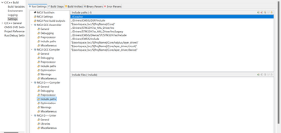

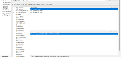

2024-11-29 1:18 AM
MCU G++ Linker> Libraries > Libraries (-l) has “arm_cortexM7l_math,” “arm_cortexM7lfdp_math” “arm_cortexM7lfsp_math”. Add these.
What should I add to MCU G++ Compiler> Include paths > Include paths(-l)?
Am I correct in this perception?
Best regards.
2024-11-29 2:25 AM - edited 2024-11-29 2:25 AM
Hello @baby_chicken
-->Add ../Drivers/CMSIS/DSP/Include path
Thank you.
Kaouthar

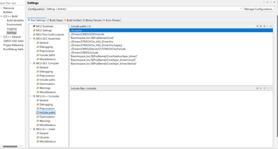

2024-11-29 2:45 AM
Is this correct?
The build went through.
Best regards.
