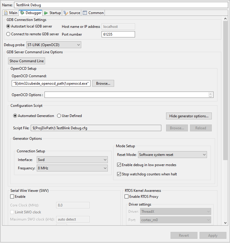

I'm a beginner in STM32.
I tried to debug STM32F103C8T6 but it always fails I have changed the st link 5 times and everything is the same there is no change, I don't know what to do,.
here are the errors and settings on my debugger
Open On-Chip Debugger 0.12.0+dev-00600-g090b431b1 (2024-09-13-19:14) [https://github.com/STMicroelectronics/OpenOCD]
Licensed under GNU GPL v2
For bug reports, read
http://openocd.org/doc/doxygen/bugs.html
Info : Listening on port 64568 for tcl connections
Info : Listening on port 62346 for telnet connections
Info : STLINK V2J45S7 (API v2) VID:PID 0483:3748
Info : Target voltage: 3.210020
Error: init mode failed (unable to connect to the target)

2025-03-17 1:15 AM
Hello @No_Name and welcome to the community;
Are you able to connect properly to your device using STM32CubeProgrammer?
Try to ensure an STLink firmware upgrade first.
Do you still have same issue?
Thank you.
Kaouthar

2025-03-17 2:36 PM
yes if in STM32CubeProgrammer it can, but I want to see the debug output of the STM32 device, I use ST-Link V2 mini, and the target is STM32 bluepill STM32F103C8T6.
