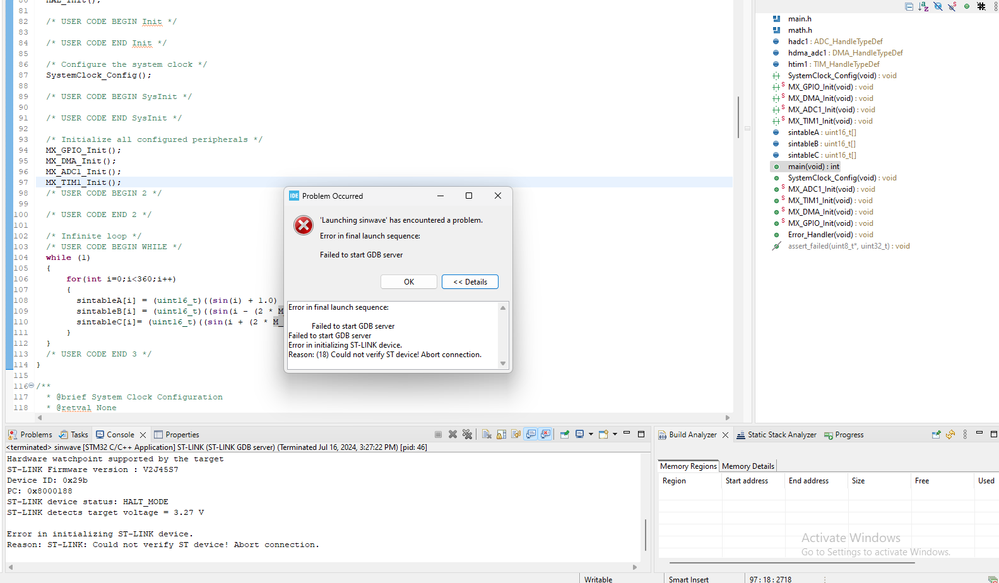

On a Blue Pill it's (virtually) certain that the STM32 chip is fake:
Are you using a genuine ST-Link, or is that also fake?
Is the PC actually detecting the ST-Link:
2024-07-16 3:02 AM
but in stm32F3 discovery, it's possible to debug
only in BluePill (f103c8t6) i cant debug
2024-07-16 3:05 AM - edited 2024-07-16 3:29 AM
@Srisudarsan wrote:in stm32F3 discovery, it's possible to debug
That will be a genuine STM32 chip
@Srisudarsan wrote:only in BluePill (f103c8t6) i cant debug
That will not be a genuine STM32 chip!
