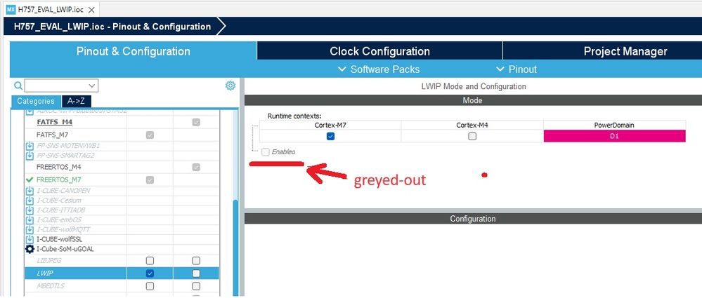

1. LWIP's "Enable" greys out if only Cortex-M7 is selected.

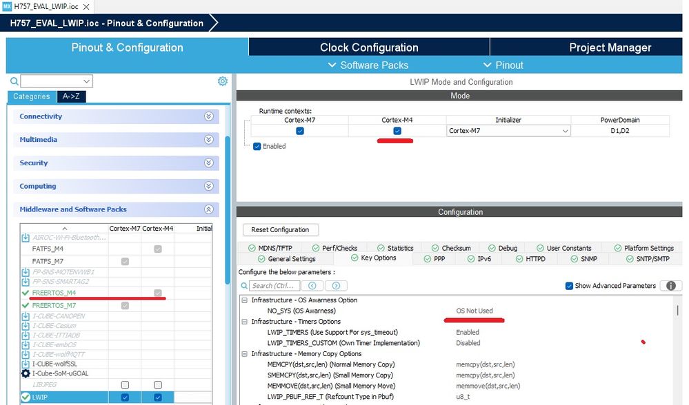

2. When both Cortex-M7 and Cortex-M4 are selected, "Enable" becomes available. However, NO_SYS (OS Awareness) is always "OS Not Used" and unchangeable.

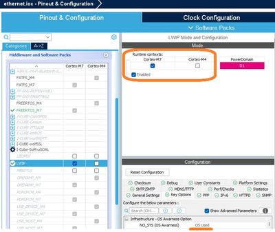

By the way, an old project, created by using STM32CubeMX version (6.8.1) and STM32Cube FW_H7 V1.11.0, does not have this issue. I can still enable LWIP with only Cortex_M7 selected. However, if migrate to the latest Mx and FW, it has the same issue.
The attached "H757_EVAL_LWIP" is the project with issue, and "ethernet" is my old one without issue.

Thank you for pointing this out. In fact, this is a known and confirmed issue and it is actively being worked on in internal ticket number 182330 and 178614 and it will be corrected in next revision of CubeMX .
this thread has the same issue Solved: NUCLEO-H755 - ETH configured (Non-RTOS) but LWIP r... - STMicroelectronics Community.
and as a workaround you can proceed by activation of LwIP for booth M7 and M4 and then you can configure it for M7, and you can enable FreeRTOS for M7 only.

2024-06-11 9:24 AM
Thank you for quick response. The most important is "LWIP->Key Options->Infrastructure - OS Awareness Option/NO_SYS (OS Awareness)" has value of "OS Not Used". This is not changeable !
As a result, the above workaround could not work.
2024-07-22 4:12 AM
Hello @Leoz ,
The correction of this issue is included in CubeMX 6.12.0 .
