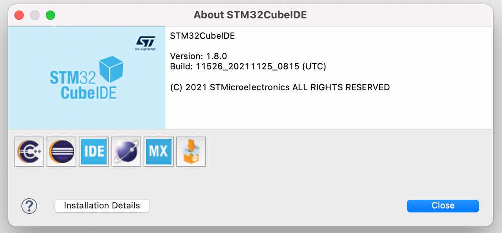

Ohhh I'm on 1.8.0!

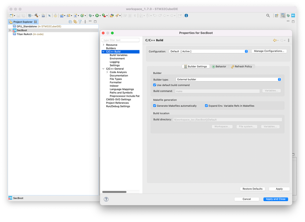

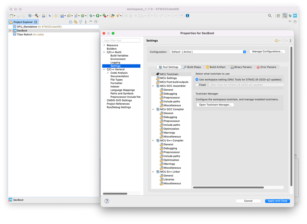

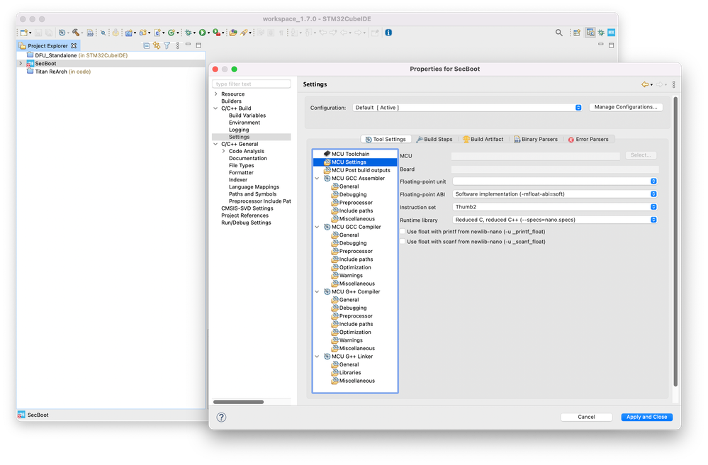

0693W00000KbJugQAF.png0693W00000KbJuqQAF.png0693W00000KbJv0QAF.png0693W00000KbJv5QAF.png
Any ideas?
