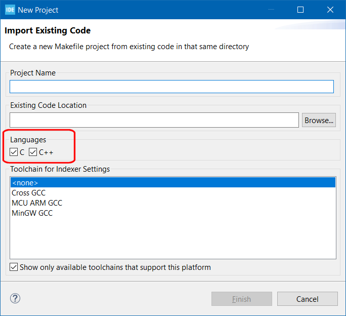

Back on the original topic of __cplusplus, I noticed this in my most recent attempt to import into CubeIDE v1.6.0:0693W000008wfYRQAY.pngI didn't notice that before - maybe it explains why the project had both "ccnature" and also "cnature" ?

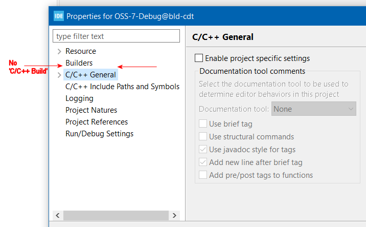

I just tried it with importing an Eclipse CDT project: that finds all the source files OK, and builds OK, but the Project Properties doesn’t have the ‘C/C++ Build’ page (it comes between ‘Builders’ and ‘C/C++ General’ for a makefile project):
0693W000008wl1nQAA.pngSo it remains impossible to debug a "plain vanilla" Eclipse Project in Cube IDE.
