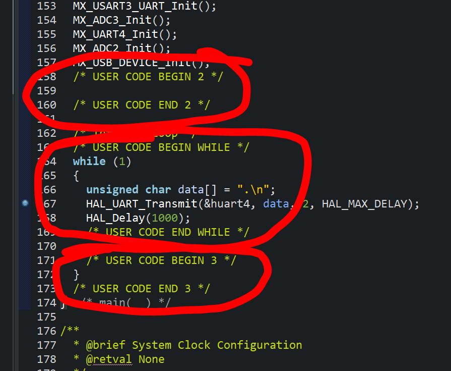

In the generated files, there are regions marked with USER CODE BEGIN and USER CODE END. You may only modify code within those sections.
Here are three of many such sections:

Keep your code within USER CODE blocks and don't make modifications outside of those.

thanks for your reply
it works with me
