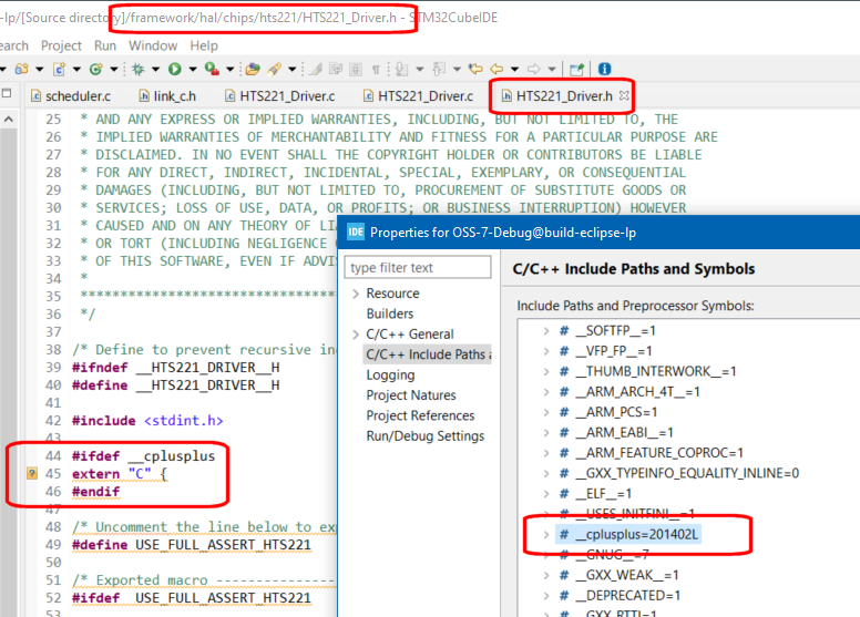

It is a 'C' Project, but the CubeIDE defines __cplusplus:
Which, as you can see, messes-up the codes checks to see if C++ is being used!
If I manually delete that definition, all is fine.

Q1: If you open the .project-file in the original project (before importing it into CubeIDE). Does it contain the node: <nature>org.eclipse.cdt.core.ccnature</nature> ??
  • cnature is only C project
  • ccnature is a C/C++ project
Q2: If you import the project into CubeIDE. Now open the .project-file, does it now contain the ccnature node?
If CubeIDE for some reason adds C++ to the project file, then it sounds like a bug. If it is part of the original content, then I would guess this is expected?!
If ccnature. then the C++ compiler is also setup for the project, and then the C++ compiler would set up the symbol "__cplusplus=201402L", assuming you are using -std=gnu++14.

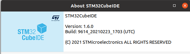

Made some edits to clarify the process after reading @Pavel A.​  post. Will see if i can setup a virtual Ubuntu machine in home office to re-produce.

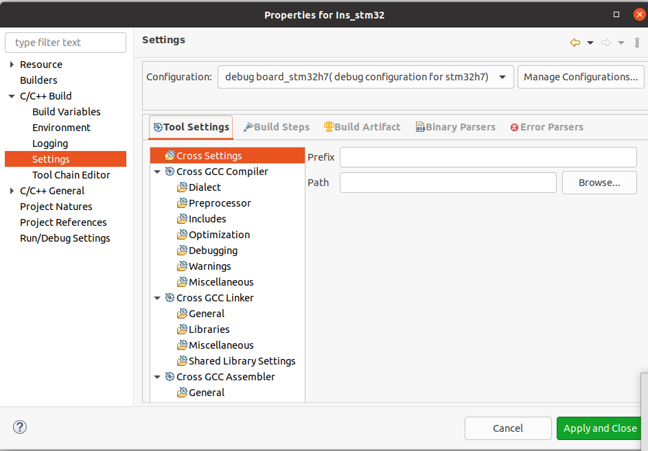

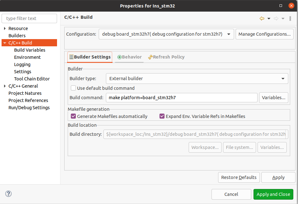

Hi @mattias norlander​
Your advise unfortunately does not work here on Ubuntu...
We have an existing makefile project.
Checked "Generate Makefiles automatically".
But this does not enable " MCU Settings"
0693W000007ZvQOQA0.pngPlease advise ? Is this working only on Windows or only for newly created makefile projects?
Thanks,
Pavel
Answering my own question...
* The trick to specify the MCU requires to create a new CubeIDE makefile project, as in the Mattias' post above.

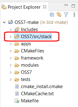

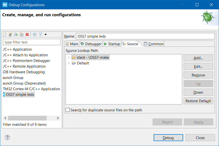

I tried adding a 'Source Folder' to the project:
0693W000008wdz6QAA.pngNote the '>' indicating that it can be expanded & has stuff beneath.

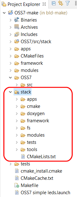

But, after I added the Debug Configuration, the 'Source Folder' became empty:
0693W000008wdzQQAQ.pngNote how the '>' has gone - there is now nothing to expand!

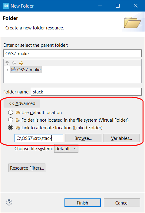

So, instead, I tried a just a 'Folder' - not a 'Source Folder' - and used the 'Advanced' options to point to the source files location:
0693W000008we0OQAQ.pngWhich gives
0693W000008we3SQAQ.pngand I could add that as a 'Workspace Folder' to the Debug Config:
and that does seem to enable the debugger to find the source files.
Perhaps someone could explain the difference between a 'Folder' and a 'Source Folder' ?
perhaps I should add that the structure of the OSS-7 tree is like this:
OSS7 ---+--- cubewsp                    << folder for the CubeIDE Workspace
        +--- src ----+--- stack ...     << the stack source tree
                     +--- build         << the makefiles created by CMake
so the source files are not "beneath" the makefiles - they are in a tree alongside them
