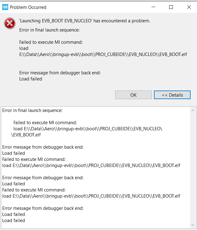

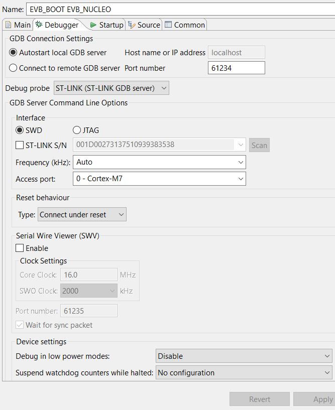

To end the horrible winter night... even the debugger fails in CubeIDE under Windows.
On the same Windows machine CubeIDE can debug the same target in a Linux VM.
Isn't it curious?
Same error with OpenOCD and ST-LINK GDB server.
Of course, Atollic just works.
Could this be related to failure to convert ELF to any other format?
-- pa
2021-02-20 6:07 AM
2021-02-20 11:53 AM
Well, one mystery less. Failure to load the .elf was because CubeIDE after importing Atollic project could not find the linker script.
So it silently used default layout that starts from address 0. Of course this wasn't gong to work.
The question is now why the linker does not print error message if script file specified with -T parameter cannot be opened.
And why arm-none-eabi-size and objcopy won' run.

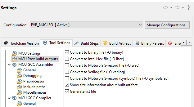

Still struggling to understand why CubeIDE does not not run specified post-build actions.
No bin file and no list file. Only .elf and .map are created.
Using internal builder. Host: Win10 Home v.20H2.

But I don't know how to get a list file.
Why CubeIDE fails to call the same programs??
