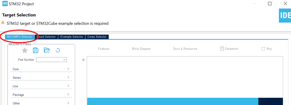

Hello!
Today there's no possibility to add a board to the integrated MCUFinder inside STM32CubeIDE but you can select the MCU you are developing with (select MCU/MPU Selector instead of Board Selector)
Then you can use whatever custom board you wish and make your application around the MCU accordingly.
