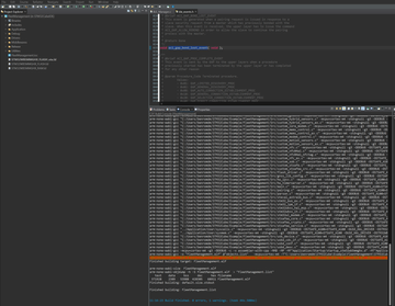

When building the generated project, I get two compilation errors:
1) Master_Clock_Accuracy field not found (should be Central_Clock_Accuracy)
File: STM32Cube/Example/FleetManagement/Src/astra_app_ble.c
Line: ~603
Error:
STM32Cube/Example/FleetManagement/Src/astra_app_ble.c:603:81: error: 'hci_le_connection_complete_event_rp0' has no member named 'Master_Clock_Accuracy'; did you mean 'Central_Clock_Accuracy'?
603 | handleNotification.Master_Clock_Accuracy = connection_complete_event->Master_Clock_Accuracy;
Workaround/Fix:
Replace Master_Clock_Accuracy with Central_Clock_Accuracy, e.g.:
handleNotification.Master_Clock_Accuracy = connection_complete_event->Central_Clock_Accuracy;
2) Conflicting prototype for aci_gap_bond_lost_event
File: STM32Cube/Example/FleetManagement/Src/BLE_Manager.c
Line: ~4464
Error:
STM32Cube/Example/FleetManagement/Src/BLE_Manager.c:4464:6: error: conflicting types for 'aci_gap_bond_lost_event'; have 'void(void)'
 4464 | void aci_gap_bond_lost_event(void) {
Workaround/Fix:
Update the function signature to match the expected prototype:
void aci_gap_bond_lost_event(uint16_t Connection_Handle) {
It looks like the generated example sources are not aligned with the current BLE stack / header definitions shipped with STM32CubeWB FW_WB V1.24.0.
Thank you.

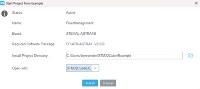

Hello @remiA ,
I checked the behavior described and the issue was not reproducible by my side.
I did not get compilations Errors.
Thanks.
