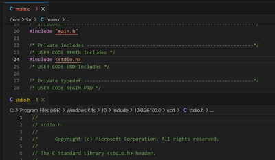

2026-02-15 4:53 AM - edited 2026-02-15 6:18 AM
I recreated it easily.
1. Moved "bundles" and "packs" from "C:\Users\###\AppData\Local\stm32cube" into "C:\ST\st bundles" and "C:\ST\st packs".
2. Created Windows User environment variables.
CMSIS_PACK_ROOT=C:\ST\st packs
CUBE_BUNDLE_PATH=C:\ST\st bundles
3. Created new random blank CubeMX project for CMake toolchain. I used STM32F100 MCU and saved IOC into "C:\ST\demo" folder. Generated the code.
4. Opened the project folder with vscode. Let ST extensions discover and configure the CMake project. It found right tools:

}7. Went to main.c and typed "include <stdio.h>". Open it's definition. Since I have Microsoft Windows SDK installed, it found stdio.h from there.
8. Include something more embedded, like <elf.h>. It's not found:
