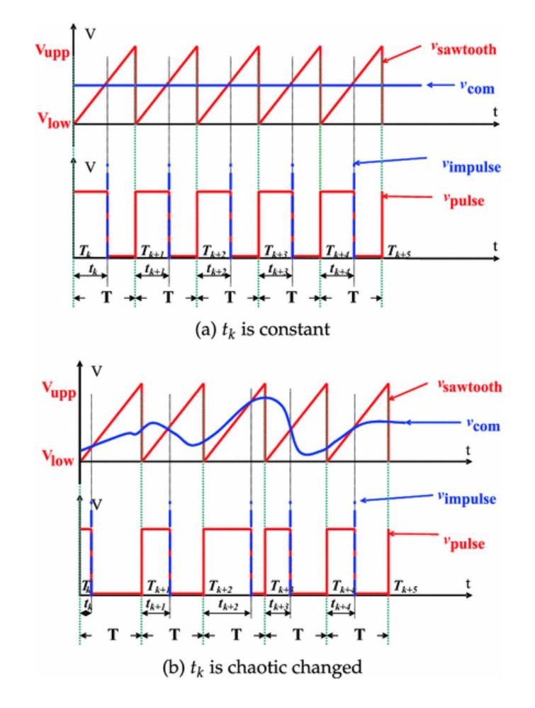

I have never before worked with a microcontroller so all of this is very new to me. I am using the MC-kit IHM07M1 with the NUCLEO-F302R8 as a control board. I am trying to implement chaotic PWM in the microcontroller like in the figure attached. The sawtooth pulse is, as seen in the figure, an upcounting timer.
The ARR needs to be constant and the CCRx values of each channel are going to vary chaoticly. My problem is that no matter what I do I simply can't implement this in my code. I am starting with a project in MotorControl Workbench (just a default Bull-Running-Program), and from there I generete my code. This is how I set up the workflow for my code:
