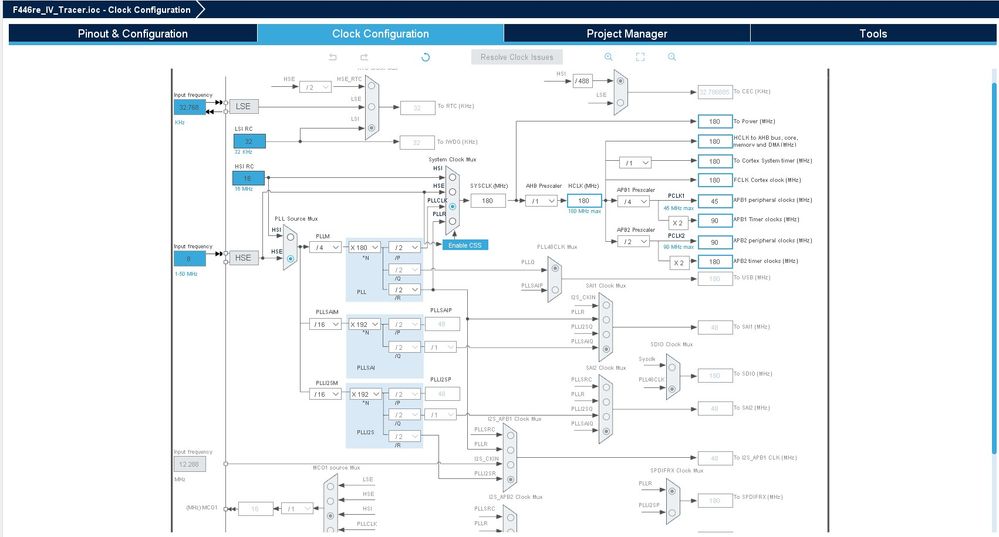

I am using NUCLEO-STM32F446re board. It runs at 180MHz SYSCLK and ADC uses APB2CLK that can run at a maximum frequency of 90MHz. I am using STM32CubeIDE and the clock configuration looks as follows:

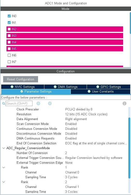

My ADC setup looks as follows:

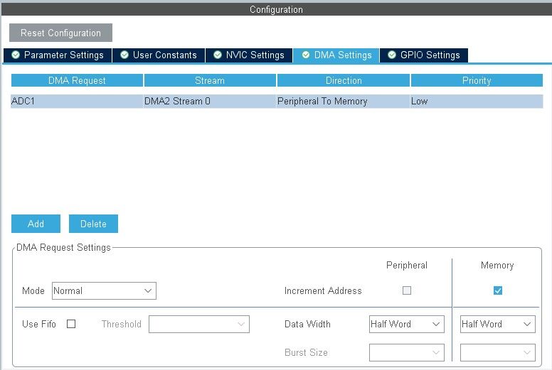

My DMA setup:

When I use an ADC Clock Prescaler = PCLK2 divided by 8 (90MHz / 8 = 11.25MHz).
Lets assume what I am measuring (7.6us) is correct. When I then almost double the ADC frequency by changing the Clock Prescaler = PCLK2 divided by 4 (90MHz / 4 = 22.5MHz)
Please advise me on what concept am I failing to understand? I would like to start ADC with software and not a timer or so, because there is code written in While() loop that is being started manually.
I have tried to include everything that is necessary with the code and the diagrams, if I might have missed important aspects that doesnt explain my problem clearly please let me know.

What you are measuring is mostly the speed of software. Of course, the HAL is broken bloatware and normal code can achieve higher speeds, but still that is just not the right approach.
One cannot get a maximum speed and accurate frequency with a software. To get these one has to use either a timer or continuous conversion mode.

Calculate the time spent in the HAL library and your code detecting and servicing the end of conversion, toggling the GPIO pin and starting conversion again.

I tried to do that in the complete call back function. I thought by toggling the pin I am trying to calculate the time it takes to for ADC conversion and the DMA.
How do you advise me to calculate the time spent in the HAL library?

I have attached my ADC and DMA setup in my main question. Is there anything you are able to quickly notice that is wrong with my settings?
2022-09-05 11:44 AM
The timer triggers ADC conversions and DMA transfers data from ADC to RAM. In this scenario the sample (trigger) rate is independent of ADC conversion time, just ensure the conversion time is shorter than the trigger period.
