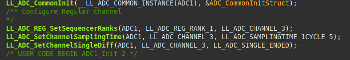

2022-10-28 12:21 AM
after >> generate code
look in main.c -> MX_ADC1_Init(void)
and you should see somthing like this:
Cube should set the ADC as you did in configuration;
the "set" - functions are in xx_ll_adc.h .
