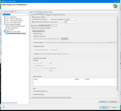

Settings for the debugger:

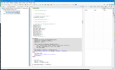

Screenshot of a debugger session:
