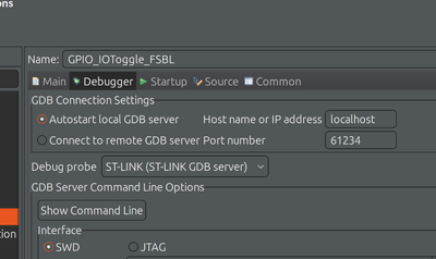

2025-01-09 2:35 PM
when you click to show the "Show Command Line" button what does it resolve to?
2025-01-10 1:49 PM
When I click on "Show Command Line" I get this:
${stm32cubeide_openocd_path}\openocd.exe "-f" "b_u585i_iot02a_ntz_debug.cfg" "-s" "C:/iot-reference-stm32u5/Projects/b_u585i_iot02a_ntz" "-s" "C:/ST/STM32CubeIDE_1.17.0/STM32CubeIDE/plugins/com.st.stm32cube.ide.mcu.debug.openocd_2.3.0.202411041438/resources/openocd/st_scripts" "-s" "C:/ST/STM32CubeIDE_1.17.0/STM32CubeIDE/plugins/com.st.stm32cube.ide.mpu.debug.openocd_2.2.0.202409171044/resources/openocd/st_scripts" "-c" "gdb_report_data_abort enable" "-c" "gdb_port 3333" "-c" "tcl_port 6666" "-c" "telnet_port 4444"Unfortunately it doesn't resolve the path variable - as you can see.

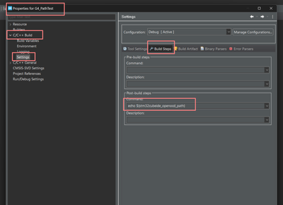

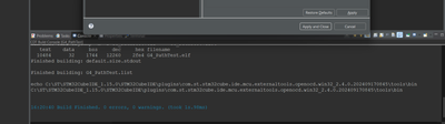

2025-01-10 2:22 PM - edited 2025-01-10 2:24 PM
One way you can check what the actual env variable resolves to by adding a post build command.
Right click on your project and select: Properties->C/C++ Build->Settings
