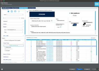

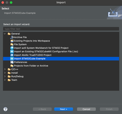

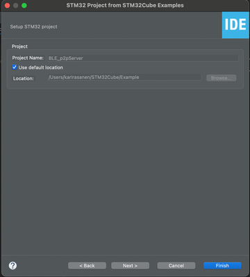

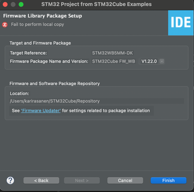

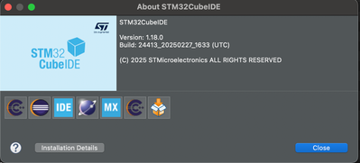

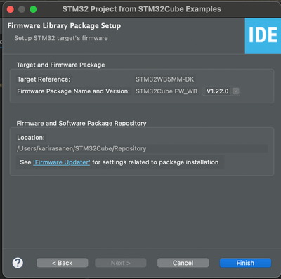

What could be wrong with BLE_p2pServer example project import here? Happens with other example projects as well. Images should have all needed information like steps to reproduce, board version, CubeIDE version etc. Operating system is MacOS Sequoia 15.3.2.
2025-04-03 4:26 AM
Hello @karppa ,
The issue has been reported to the Development Team (Internal Ticket Number: 196779)
As a workaround, I suggest that you import the project manually from the workspace folder
Thanks.
Mahmoud

2025-04-03 4:26 AM
Hello @karppa ,
Thanks.
Mahmoud
2025-04-03 10:12 PM
Hi Mahmoud,
I managed to get working example by creating it in STM32CubeMX and importing it manually to CubeIDE.
Thanks,
Kari
