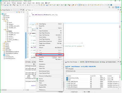

I need to copy text from internet to Cube IDE main.c file.
I copied the text from the internet, I click in the Cube IDE context menu "paste".
And nothing happens.
If I copy text from Cube IDE and paste that text into Cube IDE, then the text is pasted.

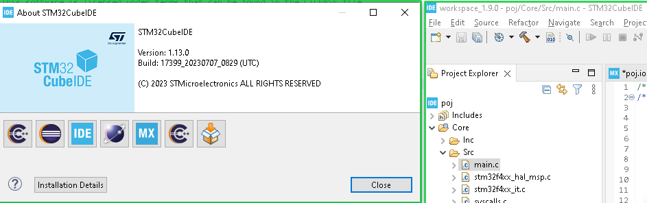

>I tested to copy-paste from your post (internet) to file main.c in cubeide 1.12.1
Recently there was an update of the Cube IDE, maybe this is a problem
