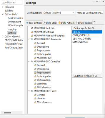

As a workaround :Right click on the CM0+ and go to Properties -> C/C++ Build-> Settings -> MCU/MPU GCC Compiler -> Preprocessor -> Change the CORE_CM0+ to CORE_CM0PLUS
This issue has been already identified and escalated to dev team under internal ticket number  217503 and it will be fixed as soon as possible .

Many thanks Ghofrane, now it works perfect!!!!
I suppose that thie very specific preprocessor modification form CM0+ to CM0PLUS should be carried out in every dual core project.
