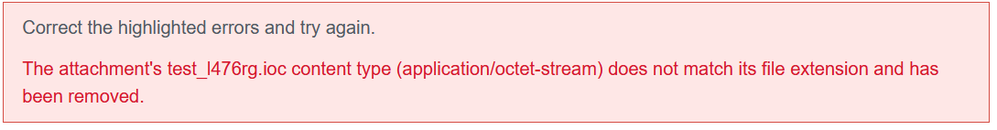

2023-07-13 2:54 AM
Hi Peter,
I am not able to attach the .ioc file (see the attached error message)
2023-07-13 3:25 AM
OK, we need to check again why IOC files are blocked. As an interim measure, could you please try renaming the IOC file to *.IOC.TXT?
