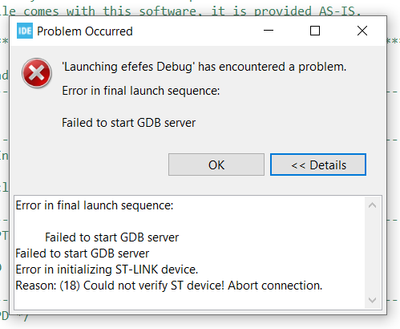

I can connect in STM32CubeProgrammer my BluePill but can't do that in STM32CubeIDE.
I fixed that my ST-LINK's pins were reverse in it.
The problem I get is,
Error in initializing ST-LINK device.
Reason: ST-LINK: Could not verify ST device! Abort connection.
I have downloaded STSW-LINK009 already. Can you help me?

Hello @xSekigan and welcome to the ST Community :smiling_face_with_smiling_eyes:.
I think you are not using an original ST part but a counterfeit one. Thats why you are receiving this message.
I suggest you verify that you are using genuine parts.

So with your none-STM chips -- you cannot debug in IDE. (IDE checks for genuine STM cpu there...)
But you can make a program in IDE, compile, then use CubeProgrammer to flash your BluePill .
If you want debug in IDE, buy an st-link with genuine STM cpu and also the target (BluePill or any) has to be STM cpu. Check, whats on your BluePill , maybe GD or CKS 32F103C8 there .

I mean your STM32F103C8T6 may be not a genuine one. You have to always ensure buying genuine products.
