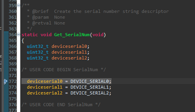

Steps for a disaster!
1
2
3
Bang! Bang! Bang!
No words....
True, you understood? Come on, it's easy...

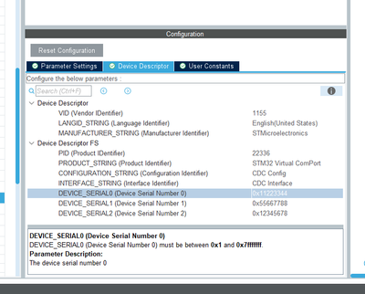

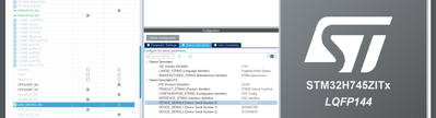

However, it would be very nice of you if you tell me the MCU reference and if possible the STM32CubeMX configuration file (*.ioc)

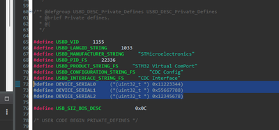

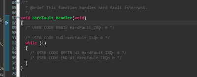

Hi, I can't send you the IOC because it is full of project pin labels. The screenshot explain actual configuaration and core. The problem is in M4 Core, but I think will be the same if USB is assigned to M7

The M4 core can't access the UID registers that the library used to use to generate the serial number. It's not a new bug, has been around since at least 2021. Still a bug.

If generated on the M7 core there is no bug.

I can understand, but here, there is also a concept problem, It's transforming an arbitrary constant to a memory pointer to read at that location an uint32. Define directly the value and you solve the problem.
2025-03-21 10:19 AM
I missed this with search, that is the right way to solve
