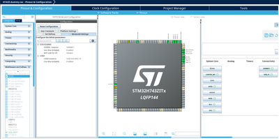

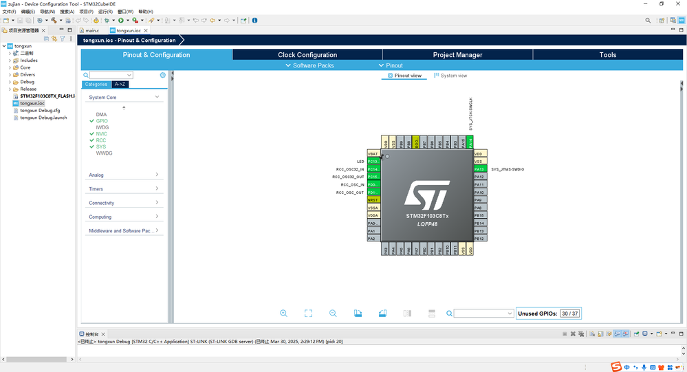

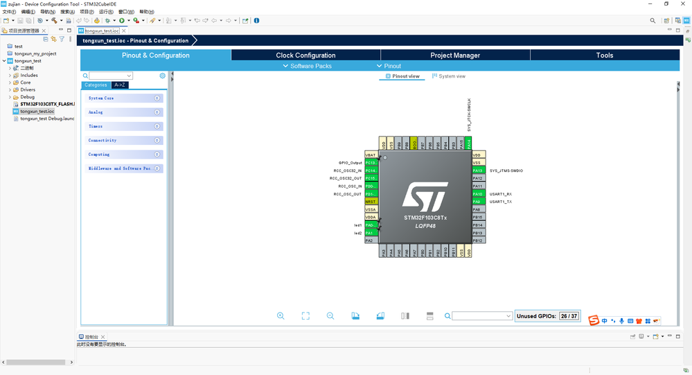

Today, after updating the latest IDE, my interface has changed to this look (Figure 1), which makes me very uncomfortable. How can I change it to the previous look (Figure 2)?

Hello @叱咤月海鱼鱼猫 and welcome to the ST Community.
This is a known limitation, after updating the STM32CubeIDE from some versions to the patch 1.18.1 using the update site updater, the GUI of the integrated STM32CubeFinder and STM32CubeMX are the images of the old UI tools. The workaround is to uninstall and reinstall the STM32CubeIDE directly from the installer on st.com.
It is already reported and added to the STM32CubeIDE:STM32CubeIDE errata 1.18.x - stm32mcu.
Best Regards.
STTwo-32

That looks unchanged from v1.13.0 - what's the problem?
If you're looking for the C editor view, click here - as before:

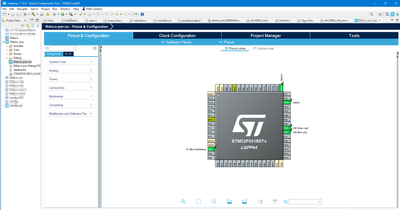

This is , what i got after update 1.18.0 -> 1.18.1 on Linux (MxLinux, up to date):
looking ok - or not ?
