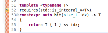

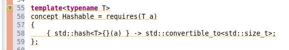

I'm writing C++ code wih STM32CubeIDE. Version of IDE is 1.11.0 and it comes with arm-none-eabi-g++ version 10.3-2021.10 . The compiler has some of C++20 features and I'm using them in the code.
The problem is some of them are not recognized by the IDE although the code compiles and runs flawlessly.
I can give3 examples that STM32CubeIDE has problem with them.

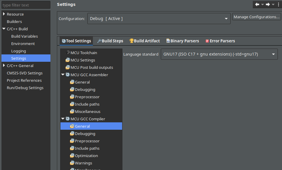

2023-01-16 8:29 AM
did you set it in project options ?
(here set C17 )
2023-01-16 10:08 AM
Yes I did. It's set on C++20. As I stated, the whole project compiles and runs.
