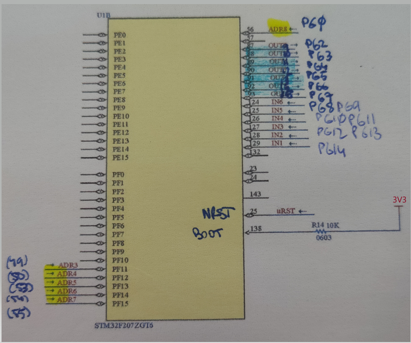

0693W00000Y8QRjQAN.pngI noticed that Nucleo board has the first configuration values by default (it is possible to see looking at the Nucleo board schematics). So when it is programmed with ST-Link GDB series, binary file is downloaded and writen on the main flash memory - before PC counter starts to increment its count -.
The custom board is an heritance from external designer. I took a look to the scheme and I could see that BOOT0 is being pulled up to 3.3V.
Obviously the start system seems not to be the same. But the fact that I don't know if this configuration was thought (even needed) to program the memory of the mcu using SEGGER J-Link.
Could it be reasonable that BOOT0 must to be tied to high?
I think not, because this board is using BOOT1 pin (B2) as a digital input, but... who knows.
I will make some fixtures on the board in order to get GND on BOOT pin instead VCC and I will try to debug once again.
Regarding clock I'm using HSI when I debug on custom board. But as I said tick timer interruptions for HAL layer drivers are not being produced after they are enabled, so clock is unable to be configured. Because I'm using HAL layer libs.
I can also see how no capacitors are connected to VCAP1 and VCAP2. According to datasheet reading this could cause internal circuitry missfunction. I hope this 1.2V internal regulator not to be damaged when SEGGER was connected and used for debugging.
I've just added some measures from VCAP1 and VCAP2 pins:
  • 1.18V
  • 1.18V
They should be 1.2V between two pins, is it?
Anyways, I will modify the printed circuit in order to discard this issue as the source of the non setup problem. I will comment here the results after completing this new step.
