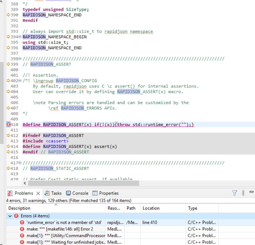

I imported a project (i'm sure it works fine) but i can't build.
Here the errors:
Does anyone can help me?

runtime_error is defined in <stdexcept>, so include that in the file that uses it.
#include <stdexcept>
Note that microcontrollers typically don't use a full C++ implementation and exceptions may not be supported depending on how your project is set up to build (Project Properties -> Tool Settings -> MCU/MPU Settings -> Runtime library). Use the full C++ implementation.

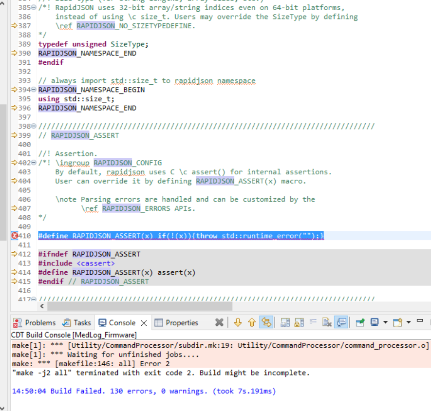

I solved that problem (thankx) but it isn't still ok
2024-10-07 9:16 AM
Your screenshot has cut off any useful error information.
Instead of the 'Problems' view, the 'Console' is more useful - select all in the 'Console' view, then copy & paste as text here.
Instructions here for posting "preformatted" text - like Conole output:

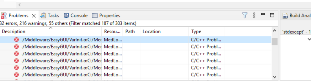

2024-10-08 7:29 AM
Sorry for the delay:
make all

2024-10-08 7:44 AM
So you have multiple definitions of the variables 'GuiVar_phChannel2mV', 'GuiVar_phChannel2Offset', and 'GuiVar_phChannel2Gain' - from files VarInit.c and GuiVar.c
You need to determine which set to keep, and which to get rid of.
