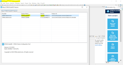

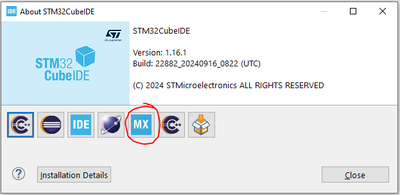

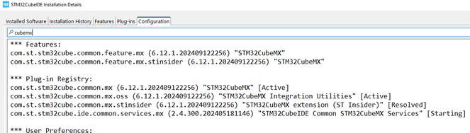

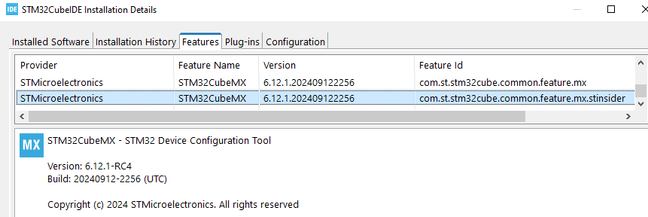

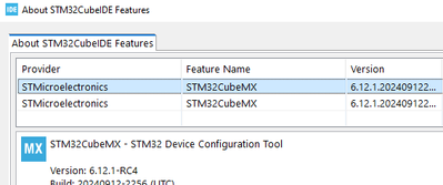

2024-10-08 6:37 AM - edited 2024-10-09 2:10 AM
To see MX version:
Help > About STm32CubeIDE > Installation Details >
1. Click the icon
2. Or 'Installation Details'
