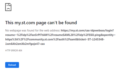

BTW the email notification one gets from this ST forum contains a dud URL and I get this
but a Reload just displays the same thing.
