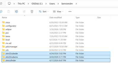

2026-04-20 3:07 AM
Hello @BrucePB
I reproduced the test and the STM32CubeIDE update was successful.
I recommend that you delete the cache folders [.stm32cubeide, .stm32cubemx, .stm32cubefinder] under this path:
C:\Users\, set the network connection and relaunch the update process.
Thanks.
Mahmoud

2026-04-27 12:44 AM
Hello @BrucePB
The Supported operating systems and architectures
• Windows® 10 and 11, 64 bits (x64)
• Linux®: Ubuntu® LTS 22.04 and LTS 24.04, and Fedora® 43
• macOS® 15 (Sequoia), macOS® 26 (Tahoe)
You find the cache folders under C:\Users\
Thanks.
