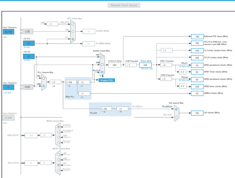

However, one problem is always making a valid clock configuration.
Setting the external clock frequency and then running the automatic configuation never seems to result in the clocks being set to full speed.
The only way I found to get the automatic configuation to get full speed clocks, is to set one of the primary dividers so that the core clock is far too high, and then the automatic clock configurator seems to try various combinations of dividers and multipliers until a vaid set of clock paramaters is found.
And even then, this doesn't always seem to work.
I looked through all the HAL examples that the STM32CubeIDE can download and use as the base for a project, but I could not see a STM32F4 example of any kind which used the .ioc config file.
All the newer examples for the 7 Series etc had .ioc based projects but the F4 ones don't seem to have been updated
If there an example F4 project I could use, this would rules out all the other unknowns, because if I create a new project from scratch the clock config could still be miss-generated by the config tool
