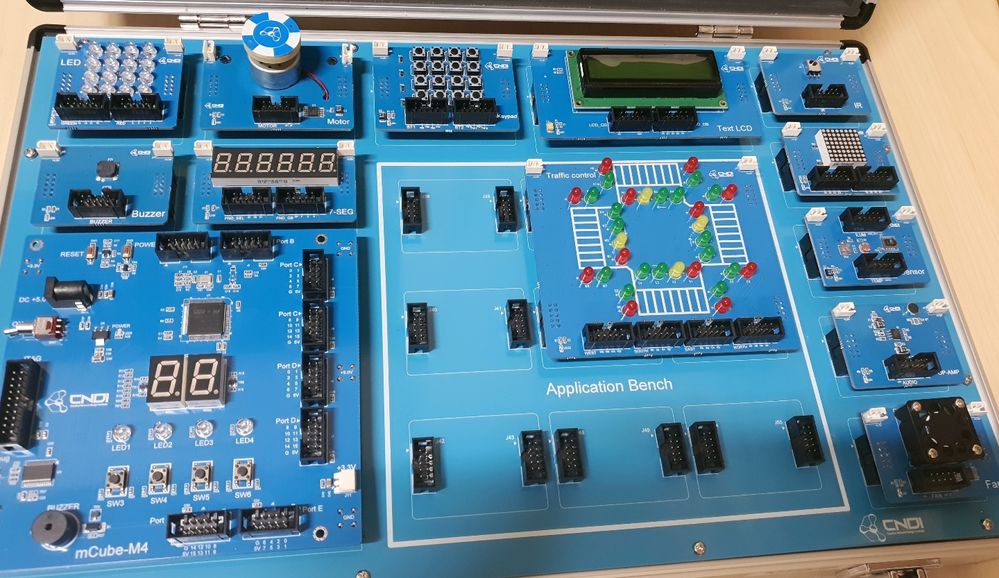

What is an "mCube micro processor", you mean mBed or or CubeMX ?
Provide a web link to what you're talking about.
0693W00000WK0yOQAT.jpgI can't proper link about mCube micro processor, so I attach photo of it.
It's made in Korea, so you may not know.​
Ok, so some MCU training board in a case. Indeed Google here was unfruitful.
Assume also we can't see your code, or the libraries your using.
Perhaps use pastebin or GitHub, it easier to get contextual clues about the forms of commands and methods if they are shown rather than described out of any context.
Here perhaps create a string that you send to the screen functions?
