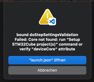

2025-10-01 9:23 AM
Hello Nawres,
I’ve made some more progress. After installing STM32CubeIDE Version 3.6.3 and following the linked guide, it seems that the Cortex-Debug extension is no longer needed. However, when I try to debug with the basic configuration provided in the guide, I get the following error:
I can add a "deviceCore" entry to the config, but I’m not sure which argument I need for the M7 core of my STM32H747IIT6 microcontroller.
I’m looking forward to your reply.
Thank you very much for your help.
Best regards,
Oskar

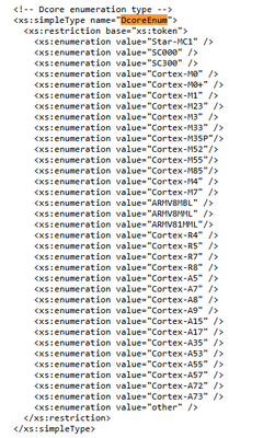

2025-10-01 12:33 PM
@OskarP
About core setup I bet on CMSIS pack schema definition this STM32CubeIDE for Visual Studio Code is relying on: https://raw.githubusercontent.com/Open-CMSIS-Pack/Open-CMSIS-Pack-Spec/refs/heads/main/schema/PACK.xsd

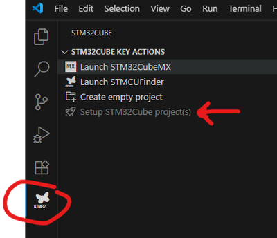

Such said I would try first to get a chance automation to help me. Have you got a try about "Setup STM32Cube project(s)" key action ?
Per my understanding it has as a result to add couple of metadata enriching your CMake project improving couple of common actions like debug launch.
In theory adding Cmake project to your workspace is triggering some stuff ending with a notification asking you to initiate this process. Missing it, this key action is allowing you to trigger on demand.
2025-10-01 11:01 PM
@Cartu38 OpenDevThank you for your reply.

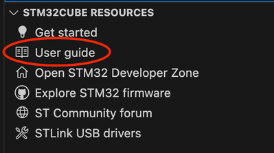

As you correctly pointed out, the core setup indeed relies on the Open-CMSIS-Pack definition. I configured my project using the "Setup STM32Cube project" option, but this did not create a launch.json file in my setup. After reviewing the user guide, I believe this is intentional, as it states that you have to add it yourself and provides a basic configuration there.
