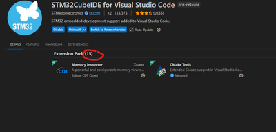

I have spent about 1 day trying to get the latest pre-release version of the extension to install correctly. If only appears to be installing 2 of the bundled extensions, Memory Inspector and CMake Tools, out of the 15 extensions that are included in the bundle. No extension icon is appearing in the left panel and when I go to Settings/Extensions the extension is not listed.

STM32CubeIDE for Visuql Studio Code pack is claiming x15 extensions but only x2 displayed (and installed you're right same on my side ... despite was ok 2 days ago and no update published according changelog since)

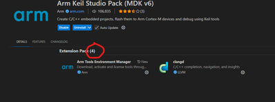

The very same applies to ARM Keil Studio pack which is claiming x4 extensions but only x2 displayed (couple of days ago I was getting the four ones ...)

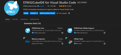

Installing them all one by one is populating the pack display what kind of demo pack itself is ok ... first time ever facing this behavior kind.
