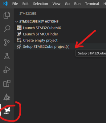

We have a large project that already defines several cmake presets, and we would like to reuse them in VS Code STM32CubeIDE extensions.
Regards
Uwe

@UStre.2 setup action not available ? .. is your CMake project building ?
Not having setup action available is sign the STM32 stuff is not detecting your project as a CMake project candidate.

@UStre.2
What happens if you just add your material to VSCode workspace ?
Have a try about adding extra STM32Cube contributions on top of:
A CMake project remains a CMake project and STM32Cube relies CMake tools extension ...

It's not selectable.
I have all configured.
Regards
Uwe

my cmake project is building, but not importable.
@Cartu38 OpenDev wrote:@UStre.2 setup action not available ? .. is your CMake project building ?
It seems so.
Regards
Uwe
