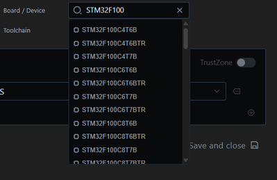

I have followed all the instructions to creating a project in MXCube and importing it into VS Code, however there is no option to select STM32F100VBT6 (Or any MCU in the F1 series for that matter). Is the STM32F1 series not supported?

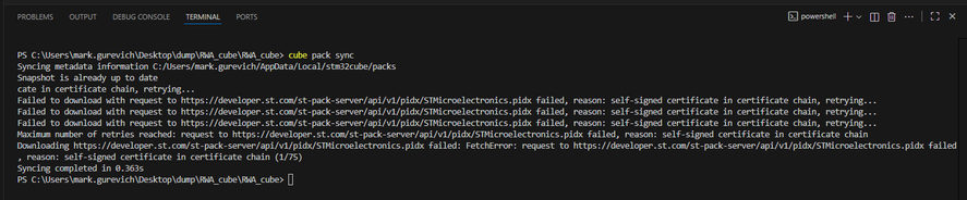

Hello @Cartu38 OpenDev , thank you for your reply. I've ran the command you mentioned and here is what it looks like:

My issue does seem to be similar to that one and likewise after following all the instructions from that thread (including exporting the certificates and referencing them to the NODE_EXTRA_CA_CERTS) there is no change in the behaviour of VS code. Neither of our issues have been solved unfortunately despite both of them being flagged as "solved" here

It worked finally after I appended and referenced the contents of the reply to the following:
$hostname = "developer.st.com"
$tcp = New-Object Net.Sockets.TcpClient($hostname, 443)
$ssl = New-Object Net.Security.SslStream($tcp.GetStream(), $false, ({$true}))
$ssl.AuthenticateAsClient($hostname)
$cert = New-Object System.Security.Cryptography.X509Certificates.X509Certificate2 $ssl.RemoteCertificate
$chain = New-Object System.Security.Cryptography.X509Certificates.X509Chain
$chain.Build($cert) | Out-Null
foreach ($element in $chain.ChainElements) {
Write-Host "----- Certificate -----"
Write-Host "Subject: $($element.Certificate.Subject)"
Write-Host "Issuer: $($element.Certificate.Issuer)"
Write-Host "NotBefore: $($element.Certificate.NotBefore)"
Write-Host "NotAfter: $($element.Certificate.NotAfter)"
Write-Host "Thumbprint: $($element.Certificate.Thumbprint)"
Write-Host ""
$base64 = [Convert]::ToBase64String($element.Certificate.RawData)
$pem = "-----BEGIN CERTIFICATE-----`n"
$pem += ($base64 -split "(.{1,64})" | Where-Object { $_ -ne "" }) -join "`n"
$pem += "`n-----END CERTIFICATE-----`n"
Write-Output $pem
