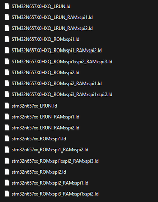

This project is a cube project provided to me by a professor for a university project. For now it's only blinking a led and checking some sensors. I imported it to CubeMX, changed the toolchain to cMake and regenerated the code. CubeMX generated twice the amount of linker files, it generated the ones I've already had in CubeIDE, and the same files with some changes and a different filename (screenshot attached).

The project I received from my professor was created in CubeIDE, and is executed in place. When I tried migrating I loaded the project into CubeMX, and changed the toolchain to cMake, then loaded the project in VSCode.
I've checked the linker scripts, and there seems to be some errors in the linker files generated by CubeMX.
While the original project has a ROM size of 2048K, the CubeMX generated file only has 511K. I've attached both of them.
