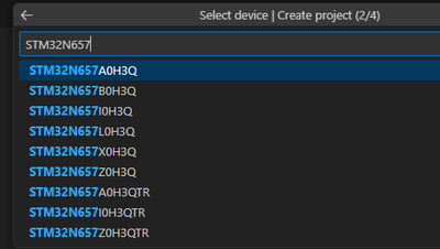

When I attempt to set up an existing project or create a new project with the VSCode plugin version 3.6.4, I do not see the STM32N6 family as an available/supported device. Am I missing a package or is something corrupted in my installation?

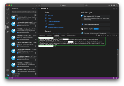

Works for me
Based on VSCode integrated terminal, what is output of following command ?
cube pack syncIf any fail reason why I guess ... (are you connected to internet, any firewall or ?)

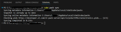

@aroby95, did you solved your issue by some way?
If not, as suggested, could you execute the cube pack sync command in VSCode integrated terminal and paste here the result?
