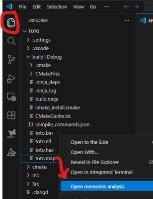

Please be aware that you can invoke build analysis by using the file explorer context menu on any map file
2026-02-12 11:46 AM - edited 2026-02-12 11:47 AM
@vincent_grenet Thanks, I have not noticed this option yet.
