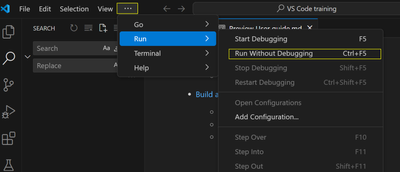

Hello @Sarra.S and thank you for your answer
I tried it and it kind of works, but not in the way I expected. When I click "Run Without Debugging" as you suggested, the debug buttons (those in the image below) still appear and the code does not execute until I click on the red square (which is the stop button, a little counterintuitive). What I expect is that when I click on "Run without debugging" the code will be flashed directly on the MCU, the debug buttons don't show up and the code does not wait for me to click any button at all.

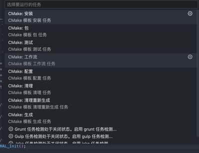

2025-07-21 11:48 PM
You can also make it the default build task by clicking the "Configure Default Build Task" option in the "Terminal" tab. A list of tasks is displayed, select the "CubeProg Flah.." command. Then you can build your project using CTRL + SHIFT + B (which performs the "Run Build Task")
2025-08-08 8:40 AM
There is no such option. Do I need to download any plugins?
