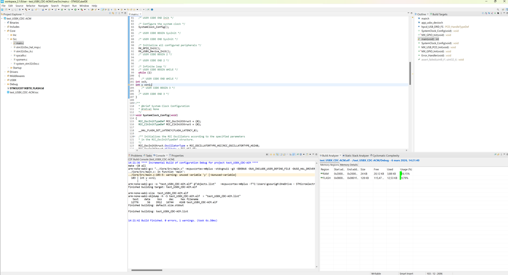

i am encountering this issue very frequently, the build analyzer unable to update after modified code and build, run.
i have click the 2-round arrow on the top right menu, and click "on request "on view build setting. Yet still unable to update build analyzer. Anyone can advise?

2026-03-01 6:26 AM
Hello.. i try the same code on STM32CubeIDE V2.1.0, the build analyzer still unable to update after i modified code , build and run. i had try to click the 2-round arrow on the top right menu, and click "on request "on view build setting. Yet still unable to update build analyzer. Anyone can advise?

The Build Analyzer is working for me, but (specialy if you have more then 1 build configuration) you have to select first the *.elf file you want to analyze , an the press the "refresh" button.
P.s. the Build Analyzer in VSCode has still some limit's and is not on the same level as the STM32CubeIDE Analyser.
