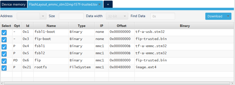

I will have to get the logs next week when I can program a board. Below is my tsv, I don't use the extra partitions (bootfs,vendorfs,userfs) that OpenSTLinux uses.

Hi @user_ABCD ,
Ok then assumption is a corruption of GPT partitioning at first boot.
Could you share the complete first boot trace on which you get linux prompt ?
Are you observing some filesystem decompression steps?
Once you get linux prompt, could you then try to access and check emmc partitioning ?
evaluate Linux file system size ?
Else fist time I see usage of single image.ext4 instead of legacy OSTL partitioning ?
What rational behind ?
May you have opportunity to try with the OSTL partitioning ?
Olivier

2022-07-18 7:48 AM
@Erwan SZYMANSKI
The issue appears to be that there is no "Name" on the bad image. On a good image, the "Name" appears as rootfs.
I am trying to follow some of the latest stuff on the ST Wiki. Is the PARTUUID possibly causing me issues? I have not used that in the past and unsure of the implications other than I am currently doing nothing with it.
From the ST Wiki - "The partition named "rootfs" has a specific PARTUUID."
2022-07-18 8:24 AM
@user_ABCD ,
As a first test, can you try to make your rootfs partition a System type instead of a Filesystem type ? I do not know if it as an impact on TF-A's reading capability but I just want to be sure before going further.
Regards.
Erwan
2022-07-18 8:31 AM
@Erwan SZYMANSKI
I actually had previously tried that and it does not change anything.
The 'System' partition named "bootfs" is marked 'bootable'.
This is a statement from the wiki and it is unclear what actually makes something "bootable". Anyways, System and Filesystem create the same TF-A exception.
