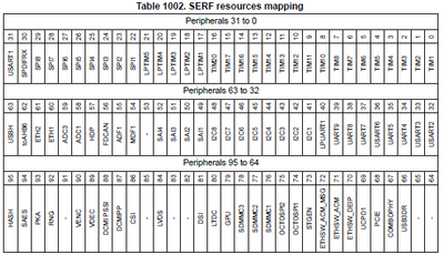

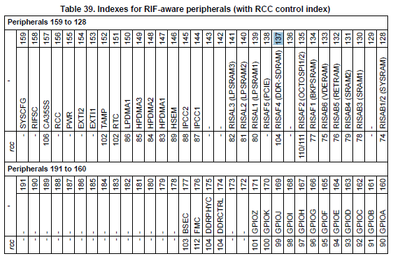

IAC event is related to security illegal access issue (RIF setting related).
according to RM0457, ID 137 is "RISAF4 (DDR-SDRAM)"
SERC event is related to SW accessing an IP which is not clocked.
according to RM0457, ID 32 is USART2
Regards.

2026-05-11 2:54 AM
Thank you. Can you post which page you found these IDs?
The only information i have found is from chapter 11.5.5, page 402.
2026-05-11 2:58 AM
RM0457 Rev5
page 349
page 5760
