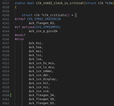

2026-04-22 4:42 AM
Hello @OKN ,
Yes you target the right file, the modification should be as below:
The added line is highlighted by the green marker on the left.
Kind regards,
Erwan.
2026-04-22 11:58 PM
Hello @Erwan SZYMANSKI
I tried adding ck_flexgen_34.
There doesn't seem to be any change in the boot log.
Best regards,
OKN
static bool clk_stm32_clock_is_critical(struct clk *clk)
struct clk *clk_criticals[] = {
&ck_hsi,
&ck_hse,
&ck_msi,
&ck_lsi,
&ck_lse,
&ck_cpu1,
&ck_icn_p_syscpu1,
&ck_icn_s_ddr,
&ck_icn_p_ddrc,
&ck_icn_p_ddrcfg,
&ck_icn_p_ddrphyc,
&ck_icn_s_sysram,
&ck_icn_s_bkpsram,
&ck_flexgen_34,

2026-04-24 2:52 AM
As a test, I removed ck_flexgen_34 and added ck_icn_p_pci.
No SERC error occurred.
It crashes immediately, but u-boot booted successfully.
Is there any connection between the changes resulting from adding ck_icn_p_pci and the SERC error?
Best regards,
OKN
&ck_hsi,
&ck_hse,
&ck_msi,
&ck_lsi,
&ck_lse,
&ck_cpu1,
&ck_icn_p_syscpu1,
&ck_icn_s_ddr,
&ck_icn_p_ddrc,
&ck_icn_p_ddrcfg,
&ck_icn_p_ddrphyc,
&ck_icn_s_sysram,
&ck_icn_s_bkpsram,
// &ck_flexgen_34,
&ck_icn_p_pcie,

2026-04-27 5:40 AM
Hello @OKN ,
You issue in OP-TEE disappeared. This crash in U-Boot looks different. We have to understand where in U-Boot it fails and why.
Maybe your DTSs from U-Boot could help here.

2026-05-11 1:31 AM
DRAM: ERROR: Failed to allocate 0x2a00000 bytes below 0x0This was resolved by deleting the linuxkernel1 node in the u-boot DT's resmem.
It now boots up to Linux.
Going back a bit...
Regarding the SERC exception, I resolved it by modifying the optee-os source code, but is there a way to handle this using DeviceTree or STM32CubeMX without modifying the source code?
Best regards,
