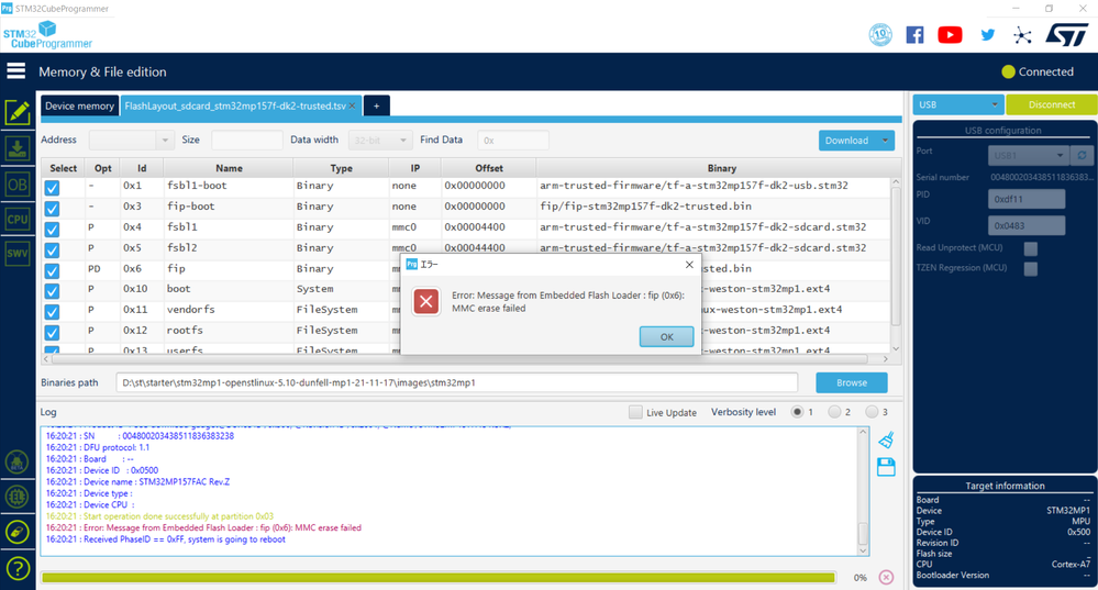

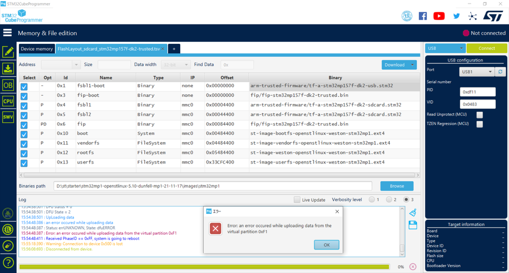

I'm trying to download Starter Package to microSD card on STM32MP157F-DK2 via USB.
I clicked "Open file", selected "FlashLayout_sdcard_stm32mp157f-dk2-trusted.csv", pressed RESET button, clicked "connect" and tried to download.
However, STM32CubeProgrammer showed the message "MMC erase failed", or "an error occured while uploading data from the virtual partition 0xF1".
Please tell me someone about what shall I do to remove these errors.

2022-06-14 11:07 PM
This problem was resolved by fixing as follows:
・Change programmer from STM32Cubeprogrammer.exe (GUI) to STM32_Programmer_CLI.exe (CUI)
・Change microSD from Kingston to SanDisk
・Change the FlasyLayout file from FlashLayout_sdcard_stm32mp157f-dk2-trusted.tsv
to FlashLayout_sdcard_stm32mp157c-ev1-trusted.tsv
Thanks.
